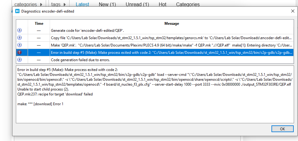

I am receiving this type of error when trying to compile code on the STM via PLECS, even though I have already updated to PLECS version 4.9.7 and also updated the target support package.
Hello Ranieri! Upgrading to PLECS 4.9.7 and STM32 TSP 1.5.1 does not cause any problems with STM32F303 MCUs for the example models that I have at hand. May I ask you to upload your .plecs file to help me reproduce the issue?
