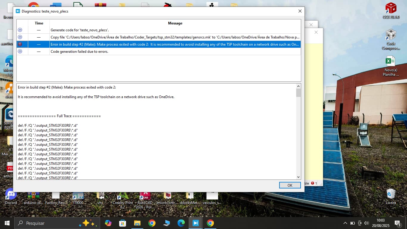

I installed a new version of PLECS (4.9.7) and I can no longer upload code to my STM32F303RE.
Note: the same error appears whether the STM is connected or if I try to upload without it connected.
Error in build step #2 (Make): Make process exited with code 2:
It is recommended to avoid installing any of the TSP toolchain on a network drive such as OneDrive.
================ Full Trace ============

N�o foi poss�vel encontrar C:\Users\labso\OneDrive\�rea de Trabalho\Nova pasta (7)\teste_novo_plecs_codegen\output_STM32F303RE\*.d
process_begin: CreateProcess(NULL, “C:/Users/labso/OneDrive/Área de Trabalho/Coder_Targets/tsp_stm32/bin/gcc-arm-none-eabi/bin/arm-none-eabi-gcc” -mcpu=cortex-m4 -mthumb -mfloat-abi=softfp -mfpu=fpv4-sp-d16 -Ofast -ffunction-sections -g --specs=nano.specs -DUSE_HAL_DRIVER -DUSE_FULL_LL_DRIVER -DPLX_BARE_METAL_SCHEDULER -DBASE_NAME=teste_novo_plecs -DEXTERNAL_MODE “-IC:/Users/labso/OneDrive/Área de Trabalho/Coder_Targets/tsp_stm32/gcc/f3/app” “-IC:/Users/labso/OneDrive/Área de Trabalho/Coder_Targets/tsp_stm32/gcc/f3/../pil” “-IC:/Users/labso/OneDrive/Área de Trabalho/Coder_Targets/tsp_stm32/gcc/f3/../inc” “-IC:/Users/labso/OneDrive/Área de Trabalho/Coder_Targets/tsp_stm32/gcc/f3/inc_impl” “-IC:/Users/labso/OneDrive/Área de Trabalho/Coder_Targets/tsp_stm32/gcc/f3/../shrd/inc_impl” “-IC:/Users/labso/OneDrive/Área de Trabalho/Coder_Targets/tsp_stm32/gcc/f3/system” “-IC:/Users/labso/OneDrive/Área de Trabalho/Coder_Targets/tsp_stm32/gcc/f3/system/cmsis/include” “-IC:/Users/labso/OneDrive/Área de Trabalho/Coder_Targets/tsp_stm32/gcc/f3/../shrd/system/cmsis/include” “-IC:/Users/labso/OneDrive/Área de Trabalho/Coder_Targets/tsp_stm32/gcc/f3/system/driver/inc” “-IC:/Users/labso/OneDrive/Área de Trabalho/Coder_Targets/tsp_stm32/gcc/f3/../shrd/system/freertos/include” “-IC:/Users/labso/OneDrive/Área de Trabalho/Coder_Targets/tsp_stm32/gcc/f3/../shrd/system/freertos/portable/GCC/ARM_CM4F” “-IC:/Users/labso/OneDrive/Área de Trabalho/Coder_Targets/tsp_stm32/gcc/f3/../shrd/system/freertos/CMSIS_RTOS_V2” “-IC:/Users/labso/OneDrive/Área de Trabalho/Coder_Targets/tsp_stm32/gcc/f3/cg” -I. -std=gnu11 -MMD -MP -DSTM32F303xE “-IC:/Users/labso/OneDrive/Área de Trabalho/Coder_Targets/tsp_stm32/gcc/f3/app/303xx” -MF./output_STM32F303RE/teste_novo_plecs_hal.d -MT./output_STM32F303RE/teste_novo_plecs_hal.o -c -o ./output_STM32F303RE/teste_novo_plecs_hal.o teste_novo_plecs_hal.c, …) failed.
make (e=2): O sistema n�o pode encontrar o arquivo especificado.
make[1]: *** [output_STM32F303RE/teste_novo_plecs_hal.o] Error 2
make: *** [all] Error 2
