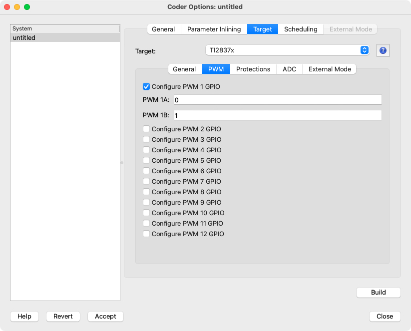

Note the TI C2000 Target Support Package has this functionality for supported targets. You can assign this setting the Target’s PWM tab accessible in the Coder + Coder options menu. See the screenshot below.
