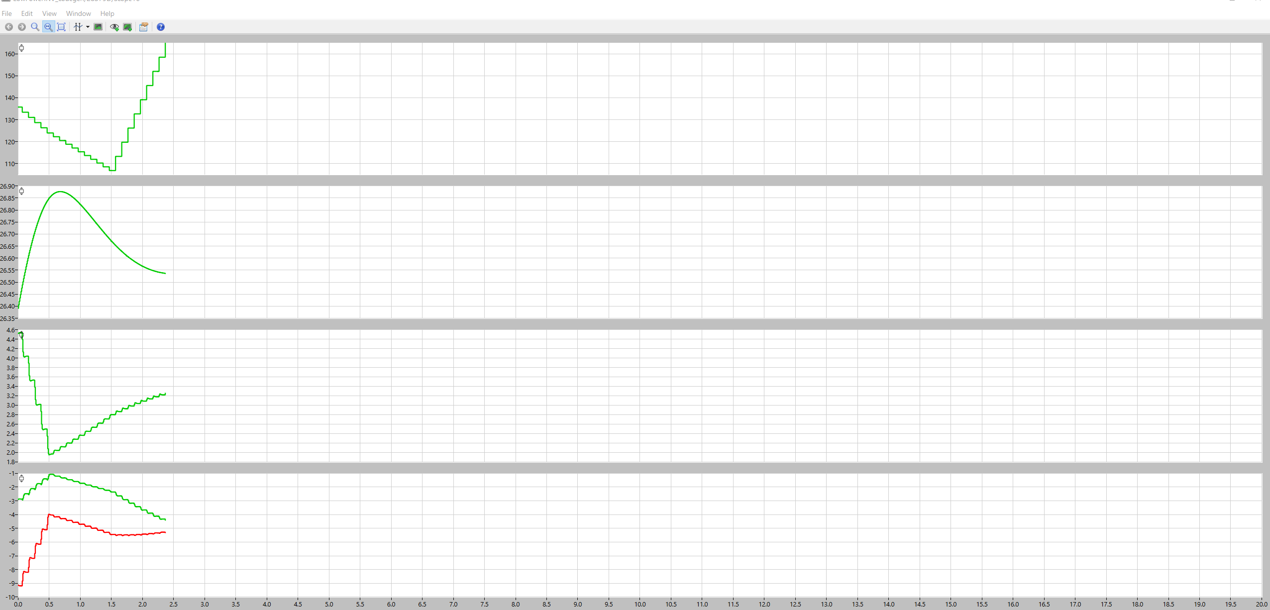

Hi, I would like to know if there is possibility to register long term values in Plecs coder. For example I would like to see estimated temperature. Sampling of this value can be very low (e.g. 1 sample per second), But I would like to see long horizon of changes (100 - 200s). When I set axis x of a scope, it doesn’t matter, new samples arriving delete previous data package. I can increase the decimation, but then it is refreshed every 100s, which is also not good, because I would like to monitor value constantly. Can I ask for any help how to do it proper way?
