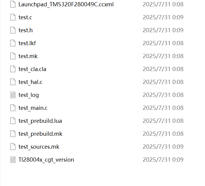

I can’t even generate the simplest code such like Blinky Model on luanchpad F280049C, because i found my compiler stop at the way to generate the file .mk.uptodate , below is the issue
test.plecs (8.9 KB) , this is so confusing
and below are my configuration
i am really really looking forward to your help please~
i’ve checked the compiler path , which seems to have no problem , then i got to test the uniflash and the cgt and not find the problems either and i failed to figure out for the compiler log that i thought might be useful for me to know what the exact step of building to work the issue out , but the test.log did not looks like a compiler log , i was almost in despire :face_with_spiral_eyes:
