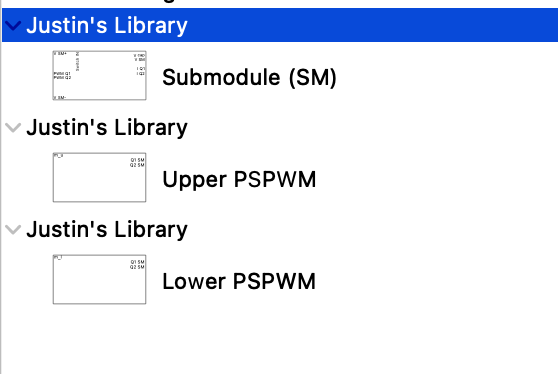

I would like all the blocks I create to be organized under a single library folder named “Justin’s Library.” I’ve been trying to move blocks around, but I haven’t been able to get them all into one folder. How can I do this please?

I suspect you currently have three separate files for each component and are adding them individually to the library browser.
If you place all three subsystems in a single file and reference that file instead, all three components will appear together under one library, as you intended.

That worked nicely! Thanks so much!
