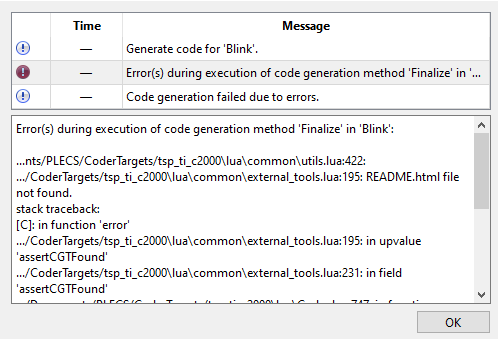

When I connect the TI launchpad with PLECS on that time I facing the error of given below.
The error indicates that your TI Code Generation Tools folder is not configured as expected. The TI C2000 windows installer should install the TI Code Generation Tools (https://www.ti.com/tool/download/C2000-CGT) automatically, however you can manually configure it as well. You receive this error when the folder exists but does not contain the expected content.
